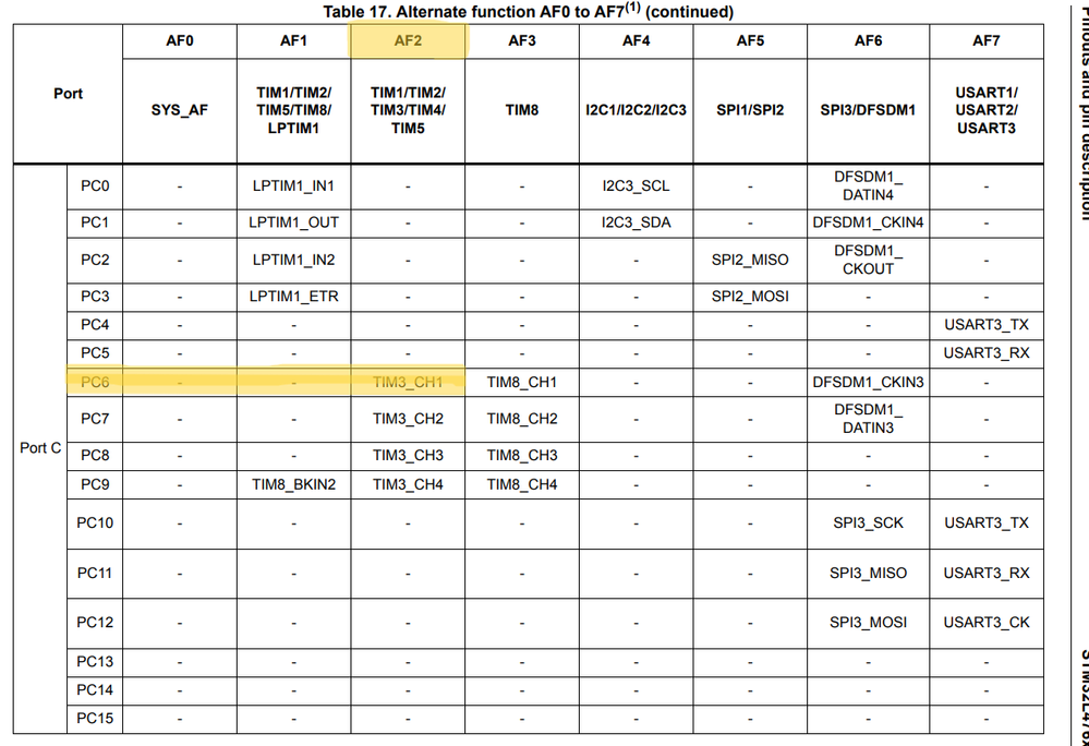

I'm writing this post because I'm facing an issue with generating a PWM signal on TIM3 for a buzzer application using the STM32L476RET microcontroller. Based on the buzzer's datasheet, it requires a 4,000 Hz square wave with a 50% duty cycle. I’ve connected the buzzer to the PC6 pin, which should work as TIM3_CH1 when configured to AF2, according to the microcontroller’s documentation.

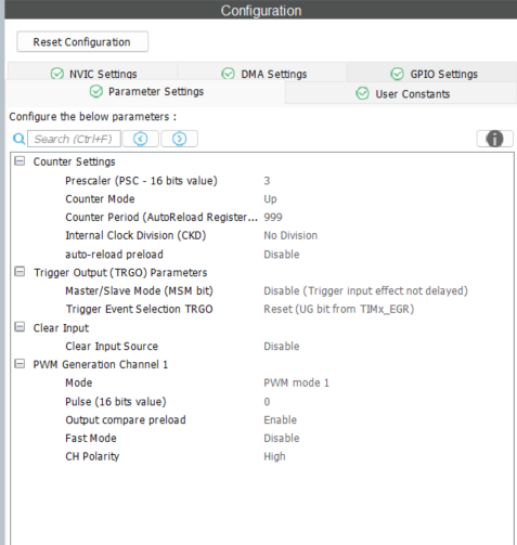

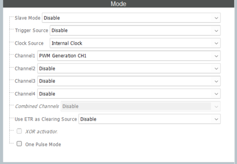

In CubeMX, I configured TIM3 Channel 1 for PWM output with these settings:
These settings were calculated based on the formula:
This results in a 4,000 Hz PWM frequency, as expected:
I did this based on microcontroller datasheet:
For the 50% duty cycle, I set TIM3->CCR1 = 500 in code.

Read out and check/post content of TIM and relevant GPIO registers.
