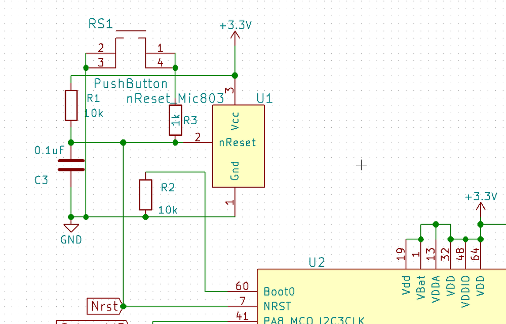

I use this on all my STM32 boards,
this is the 'F091
10K pullup and Mic803 power monitor

Thank you for your answer! I was wondering if you would ever not populate the resistor for the pull-up for a product for any reasons.
My intention is to reduce as many components as possible and leave the NRST with a 0.1 uF cap, and let the internal pull-up keep the uC on.
