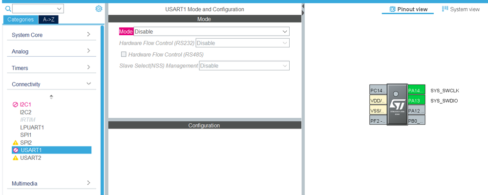

I am interested in the following question: is it possible to use the pins of the STM32G031J6M6 microcontroller first for programming (SWCLK, SWDIO), and then for another functionality, for example for UART?
Maybe there is some separate programming mode and a separate functional mode? Or for example, do I need to use Reset to perform programming? I know that the PIC10 microcontroller uses the same pins for programming and performing functions.
