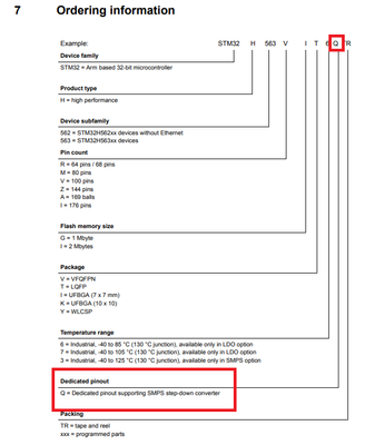

On STM32H5 it's either SMPS or LDO contrarily to H7 which has both configurations on the same package.
This is from the datasheet:
Q stands for SMPS package:

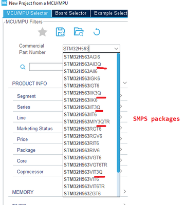

In CubeMx:
SMPS in red, others are LDO.
2025-01-02 8:06 AM - edited 2025-01-02 8:14 AM
In CubeMx:
