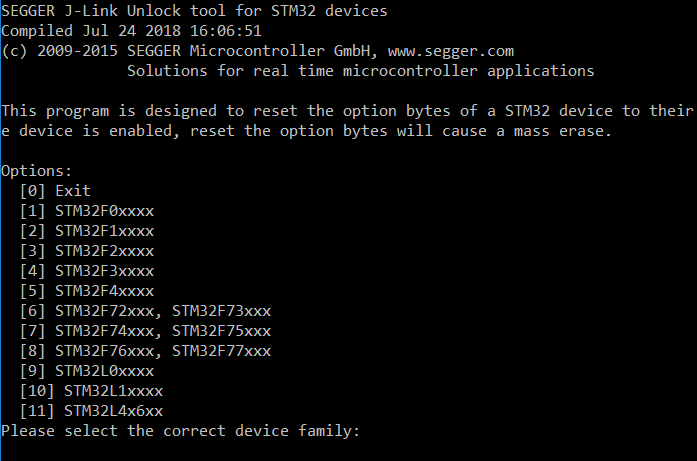

  3. I use a Jlink Segger to reset the option bytes from processors as STM32F4 and STM32F7. Unfortunately, they do not have the processor STM32H7 listed. Do you know how long will it take to get supported? Does the STM have any program with could through Jlink could connect to the processor and reset the processor to the manufacture setting?
