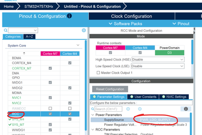

2026-01-26 3:09 PM
Did you set the power configuration to PWR_LDO_SUPPLY as mentioned in the getting startup guide?
https://riverdi.com/knowledge-base/stm32-getting-started
This is done here and is not the default:

2026-01-26 3:09 PM
2026-01-26 4:08 PM
I overlooked that in the getting started guide!
Thank you!
