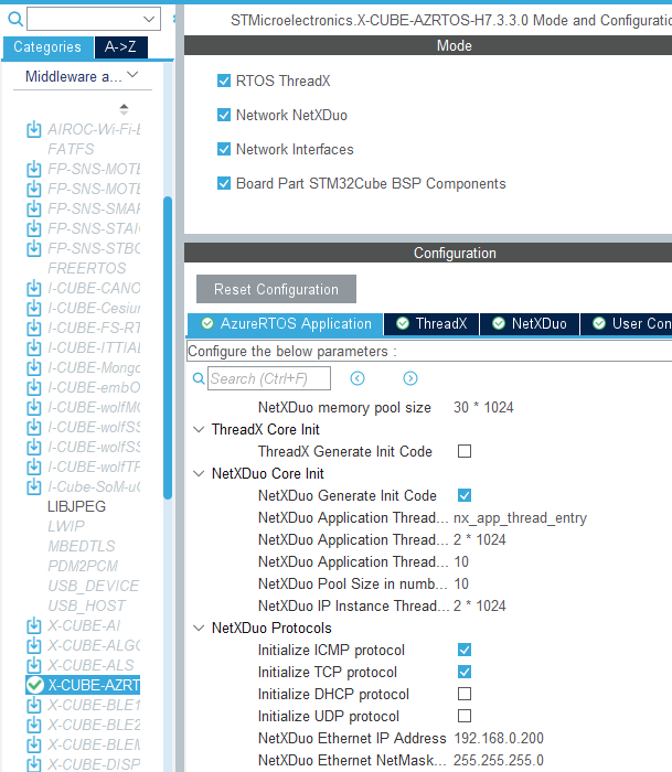

I need the TCP Server with static IP address. I chose the Nx_TCP_Echo_Echo_Server example and NUCLEO-H723ZG board as a starting point. I use the STM32CubeIDE 1.19 with latest x-cube-azrtos-h7-v3-4-0 sample files. So I imported the Nx_TCP_Echo_Echo_Server example project and compiled it without problems. But after that I disabled DHCP and set the static IP address:
After that project can't be build and it is necessary to edit app_netxduo.c file as in it still there are some code related to DHCP. But even after successful compilation I can't connect to the server from the client. Also I can't ping it too.
