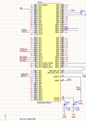

also please share your schematics and in particular if the VCAP pin with the External right capacitor. you can see voltage level at that pin to see
Hope it helps.

Thanks you. I think it would have taken me a long time to consider looking at this. I will look into it and report back. Schematic snippet enclosed. I have 2.2uF caps on the VCAP pins.
