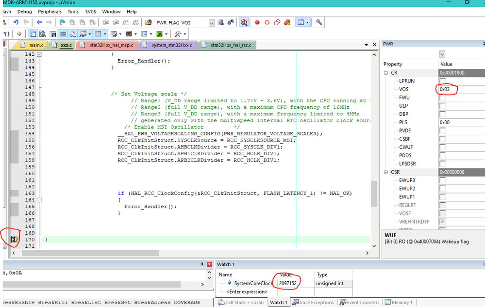

ion
, while this function is executed for the two other
ranges
(PWR_REGULATOR_VOLTAGE_SCALE1 and PWR_REGULATOR_VOLTAGE_SCALE2). I tried to change the value of this variable
(PWR_REGULATOR_VOLTAGE_SCALE3)
from
PWR_CR_VOS (
0x00001800
to 0x0000C000. With this setting, the function runs.

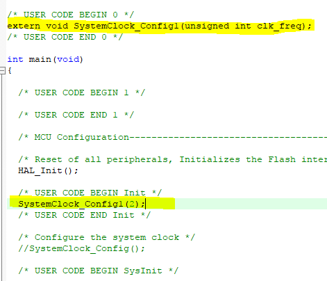

Hello !
I ran your code and i didn't faced any problem. I use
STM32CubeHALv1.8.0
and here are the results:
the code executed with 2 Mhz input.
Where exactly at your program occur this hang?
regards
vf

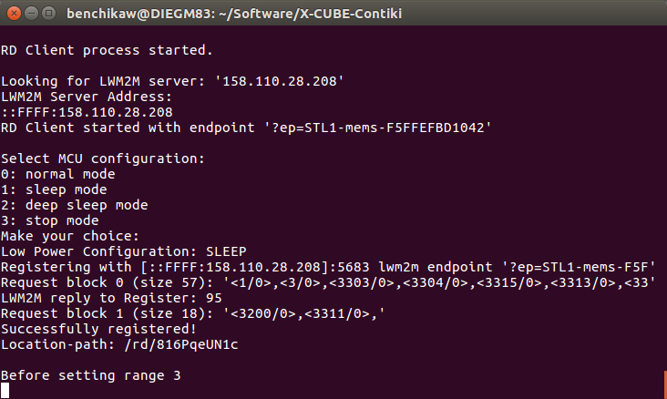

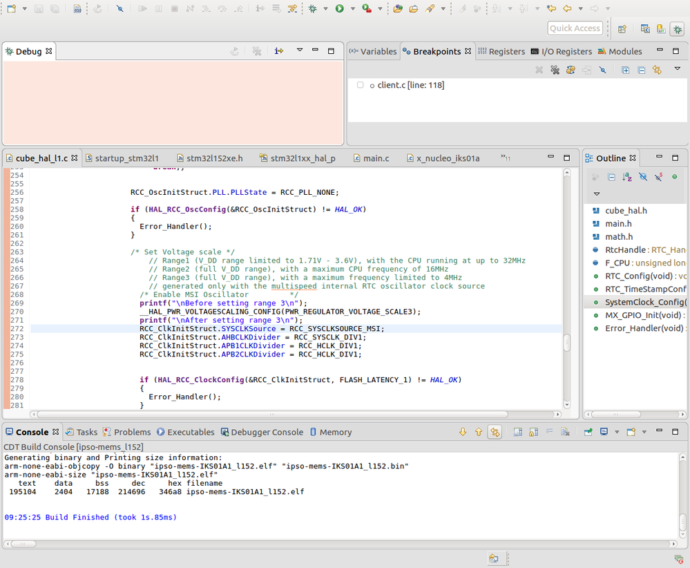

, I have added two printf (one before setting range 3 and one after setting range 3). This is to verify if__HAL_PWR_VOLTAGESCALING_CONFIG function with PWR_REGULATOR_VOLTAGE_SCALE3 is executed.
When, I run the main program and choosing sleep mode as low power mode, you can see in the following
print screen
that only the message before __HAL_PWR_VOLTAGESCALING_CONFIG function is shown which prove that this function stops the execution.Best regards,
