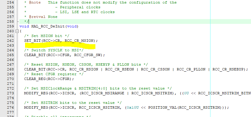

, the HAL_RCC_DeInit
function
does not execut
e
. Indeed,
the
execution
is stopped
in
the function of switching the SYSCLK to MSI
(CLEAR_BIT(RCC->CFGR, RCC_CFGR_SW);)

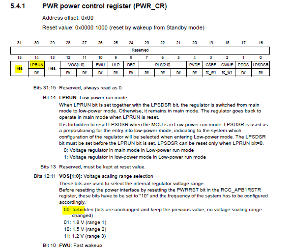

This setting leaves VOS unchanged , sets the reserved bit 15 and also sets LPRUN bit14

Please, can you verify if there are some problems in the function HAL_RCC_DeInit
It seems that HAL_RCC_DeInit function sets as systemclock the MSI , whithout check for MSIRDY flag in the RCC_CR register. Yes i thing this is a problem .

According to the RM0038 Reference manual, I agree with you that
changing the value of the variable
(PWR_REGULATOR_VOLTAGE_SCALE3)
from
PWR_CR_VOS (
0x00001800
to 0x0000C000, leaves VOS unchanged, sets the reserved bit 15 and also sets LPRUN bit14. But, the __HAL_PWR_VOLTAGESCALING_CONFIG function using PWR_REGULATOR_VOLTAGE_SCALE3 (0x00001800) stops the execution. Thus, I think that there is an error in the definition of this value.

Hello again,
In fact, when I use the function SystemClock_Config implemented in cube_hal_l1.c file (V1.0.0, date: 03-November 2014) with
a
low frequenc
y (lower than 4MHz: 1, 2 or 4MHz), I found that __HAL_PWR_VOLTAGESCALING_CONFIG function using PWR_REGULATOR_VOLTAGE_SCALE3 (0x00001800) stops the execution. Please can you verify if there is a possibility that VOS[1:0]= 00 for range 3 and VOS[1:0]=11: forbidden (bits are unchanged and keep the previous value, no voltage scaling range changed)? Indeed, _HAL_PWR_VOLTAGESCALING_CONFIG function using PWR_REGULATOR_VOLTAGE_SCALE3 (0x00000000) is executed without any problem.

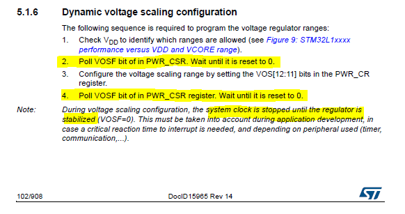

2017-10-04 10:30 AM
Hello again.
Does your code wait for VOSF flag?
If not , due to system clock stopping, your debugger will disonnect.
Take some care to follow theese note about change voltage scalling.
Regards
