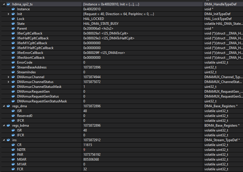

I have set up a new project using cubemx with only I2S2 in master half-duplex in attempt to simplify / isolate the issues I am seeing. With caches enabled, txBuf in D2 RAM and the circular DMA started using:
SCB_CleanDCache_by_Addr((uint32_t*)(((uint32_t)txBuf) & ~(uint32_t)0x1F), sizeof(txBuf));
HAL_I2S_Transmit_DMA(&hi2s2, &txBuf[0], 64);I am still experiencing DMA DMA1_Stream0_IRQHandler immediately re-entering (only calling HAL_DMA_IRQHandler(&hdma_spi2_tx); inside the IRQ).
I have a voltatile flag that triggers a call to main code to clean the cache after every TX complete callback.
Here are the DMA initialisation properties (HAL) for the H7:
hdma_spi2_tx.Instance = DMA1_Stream0;
hdma_spi2_tx.Init.Request = DMA_REQUEST_SPI2_TX;
hdma_spi2_tx.Init.Direction = DMA_MEMORY_TO_PERIPH;
hdma_spi2_tx.Init.PeriphInc = DMA_PINC_DISABLE;
hdma_spi2_tx.Init.MemInc = DMA_MINC_ENABLE;
hdma_spi2_tx.Init.PeriphDataAlignment = DMA_PDATAALIGN_HALFWORD;
hdma_spi2_tx.Init.MemDataAlignment = DMA_MDATAALIGN_HALFWORD;
hdma_spi2_tx.Init.Mode = DMA_CIRCULAR;
hdma_spi2_tx.Init.Priority = DMA_PRIORITY_LOW;
hdma_spi2_tx.Init.FIFOMode = DMA_FIFOMODE_DISABLE;And then for my working STM32F407:
hdma_spi2_tx.Instance = DMA1_Stream4;
hdma_spi2_tx.Init.Channel = DMA_CHANNEL_0;
hdma_spi2_tx.Init.FIFOMode = DMA_FIFOMODE_DISABLE;I have noticed within DMA1_Stream0_IRQHandler for the STM32H7 if I look at the data under hdma_spi2_tx.Instance address I can see FCR register flag intermittently set to DMA_SxFCR_FS_2, this does not happen on the F407. All other regs are the same.
Here are the registers I was observing (before and after HAL_DMA_IRQHandler I see FCR have intermittently 0x20, FIFO empty)
2020-11-01 5:10 PM
How do you know it's immediate?
Do you toggle a pin to observe the interrupt entry/exit, comparing to the I2S stream?
2020-11-06 2:08 AM
Setting a pin on ISR entry and resetting it on ISR exit. The pin ends up outputing a signal at around 200 kHz, the speed of this signal is proportional to the D2PPRE2 clock rate
2020-11-06 3:53 AM
As I've said above
> This has to be WS/[buffer halfsize] so something is very broken.
What's the fill of the signal, i.e. what percentage of time is spent in the ISR?
Find out why does it interrupt so often. Strip down the program to absolute minimum to avoid any interference from other parts; maybe better, start a new minimum project, with only the single I2S.
