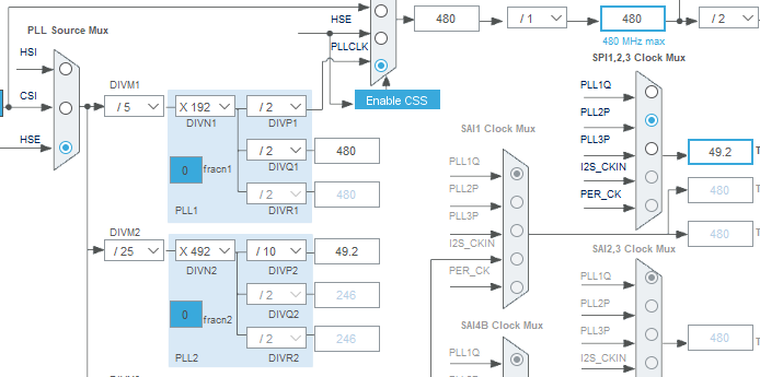

2020-10-26 6:44 AM
15.42 kHz WS, expected 48 kHz (correct on F407)
1 MHz I2S data clock, expected 3.067 MHz
Interrupt calls for stream0 and stream1 varying between 170 kHz to 210 kHz
If I comment out HAL_I2S_Receive_DMA I get a more consistent 240 kHz interrupt frequecy.
Here is my clock setup from cube:
(Edit: have lowered mcu to 120 MHz, I2S clocks still incorrect)
2020-10-26 7:21 AM

It is fast, and not intentional. On my F407 project with the same cubemx setup I have 2 us per interrupt on each stream and about 320 us between interrupt calls. On the H7 project (with same I2s configuration, and almost identicalPLL clock) I am now getting 2.5 us per interrupt but only 10 us between calls, also with my i2s clocks only running at 1/3 of the values I configured them for (observed on scope)
2020-10-26 8:38 AM
I have noticed that changing the value of D2PPRE2 in cubemx directly affects the frequency of DMA interrupts
Edit: also removing DMA and using interrupts I still get 1/3 the I2S clock speed I configured cube for but can't immediately spot any issues with the initialisation code. This is very fustrating given it worked fine on the F407.
2020-10-26 9:43 AM
This has to be WS/[buffer halfsize] so something is very broken.
Check your clocks settings. Read out and check/post relevant I2S/DMAMUX/DMA registers content. Make sure the ISRs properly clear the interrupt sources. Using Cube is no excuse, it's your code now.
