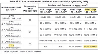

Hi @mete ,
Check also the flash memory wait states number (from RM0481 rev 1 / Table 37):
In your case it should be 5WS.

Hi @mete ,

Totally forgot about the wait states. Thanks for reminding. I changed it and it works fine.
