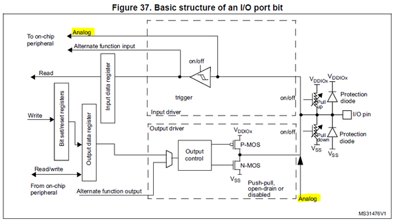

Perhaps the following figure from the reference manual also helps to illustrate the problem:
If this is accurate, it looks like the Analog signals are attached to the pin after all the port muxing/configuration of alternate functions. Assuming the OPAMP output is connected to the highlighted Analog line (on the bottom right) this means that, no matter how the pin is configured, that signal will still find its way onto the line (and visa versa).
