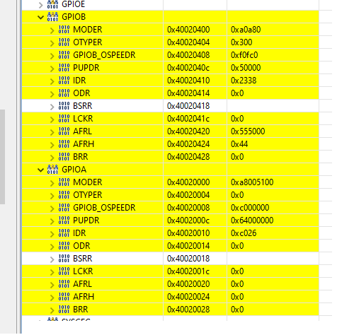

this is the state of GPIOA and GPIOB register:

I have solved!
The problem it was the reset state of my touch controller. After the Gpio init routine, the PA6 pin it was set to low and this hold the touchscreen controller in the reset state, so it can't receive any command from the I2C interface.
