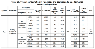

Here is one of many such power consumption tables from the datasheet:
