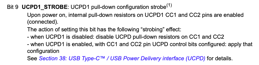

2025-07-16 9:32 AM
@Andrew Neil Thank you!
The STOBE Bit was the issue.
I set the appropriate bit in SYSCFG1 and now it all works as expected.
You have saved me a lot of grief! Who would have thought the Pull-Downs would be enabled when the UCPD Device is disabled?
2025-07-16 9:56 AM
@KMill wrote:The STOBE Bit was the issue.
Great - please mark the solution.
@KMill wrote:Who would have thought the Pull-Downs would be enabled when the UCPD Device is disabled?
Always good to check those little footnotes on the the pinout table - there's a few gotchas!
