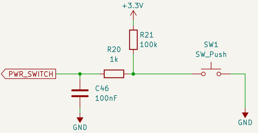

Fixed by TDKs suggestion in this post...
"Probably should put the delay before you clear the flag. If not debounced, the flag is certainly getting set immediately after you clear it and/or when button is released."

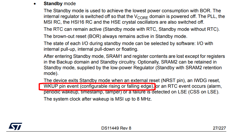

@freeflyer wrote:Does it matter which edge I used (rising or falling) ?
See the Datasheet; eg,
@freeflyer wrote:once the MCU is awake and running, am I still able to read this pin as a digital input ?
Yes.
2025-07-10 2:53 AM
Thanks Andrew, I did see that the edge is configurable.
I was just wondering if there is an advantage to using one edge compared to another, such as power consumption etc

2025-07-16 12:23 PM
