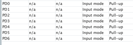

I have Port D bits 0 to 6 set up for GPIO Input, with pull-up enabled.

I have checked through the rest of my code and it's not doing anything else to PORT D, and the alternate-function registers (PORTD->AFR) read all zero immediately before reading from the IDR.

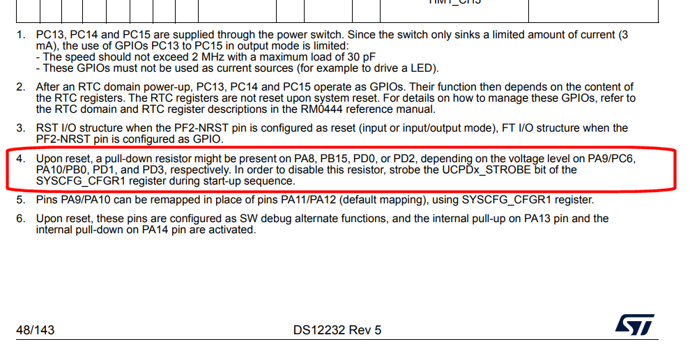

2025-07-16 9:09 AM
Which board do you use?
In DS12232 section Pinouts... PD0 and PD2 are said to have an IO structure of "FT_c" where the _c means "USB Type-C PD capable" and they have an additional function of UCPD2_CC1 resp. UCPD2_CC2.
Does your board have an USB port connected to them?
2025-07-16 9:12 AM

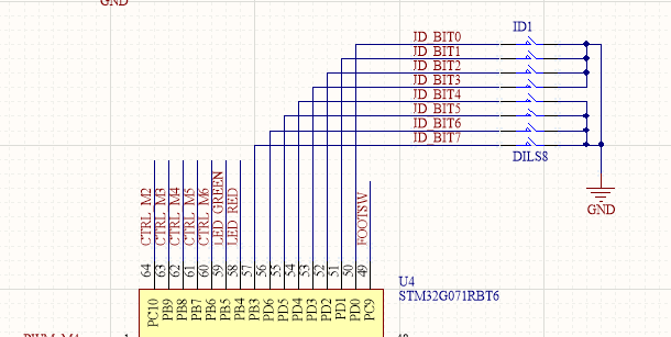

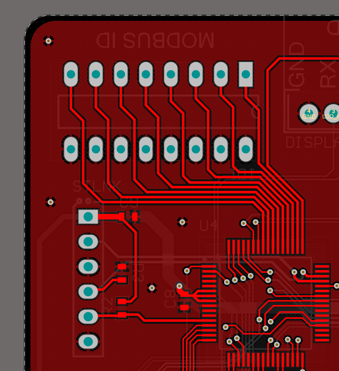

It's a self-designed custom PCB with nothing else connected to those pins.
This is the schematic for that part:
And the PCB (top view)
Keep in mind that I have measured the PCB Traces and resistance/conductance when powered off is all as expected.
So now I'm wondering if there's something USBish going on... maybe my USB perohperal is enabled... I'll check.
2025-07-16 9:21 AM
AHA! A smoking gun!
Thank you - that sounds like exactly the sort of thing that would cause this. I'll try strobing that bit and see what happens.
