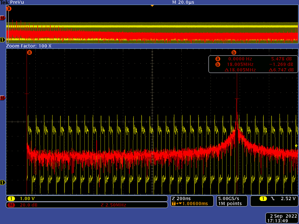

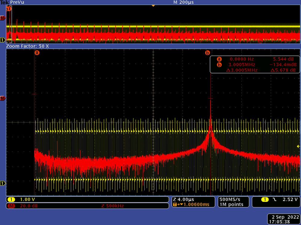

MODIFY_REG(RCC->CFGR1, (RCC_CFGR1_MCOSEL | RCC_CFGR1_MCOPRE), (RCC_CFGR1_MCOSEL_0 | RCC_CFGR1_MCOSEL_2) | (3 << RCC_CFGR1_MCOPRE_Pos));Just to check, this is what my scope gives me on MCO (PA/CN13-D9), when using SYSCLK on it. It gives nearly perfect 3MHz (24MHz/8). But the PLL1R is at 18 MHz, which means that the VCO has a frequency of 144 MHz, instead of the 132 MHz that I've configured (24MHz/2*11). What am I missing?
2022-09-02 6:11 AM
Argh, found it N of 11 implies a divider of 12
