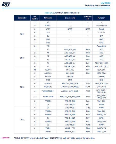

I am looking for an LCD Touch display for B-U585I-IOT02A Discovery kit but I could not find any. Is this possible to connect a local Touch LCD screen to the B-U585I-IOT02A Discovery kit? It looks like the STM32U585AI MCU does not contain any display accelerator but is it possible to connect a touch display via Arduino connectors?
Thanks!

What do you mean by "local Touch LCD screen"?
I think you need to choose an LCD touch display that can communicate over interfaces supported by the Arduino connectors on the Discovery kit.
For that I recommend you to refer to the UM2839 for the Arduino connector pinout.
