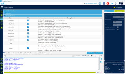

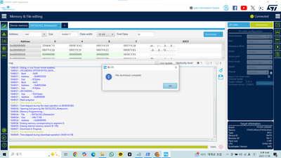

To recover it, I performed a full flash using STM32CubeProgrammer + ST-LINK (SWD), with the official firmware:
C:\Users\User\Downloads\fp-sns-datalog2\STM32CubeFunctionPack_DATALOG2_V3.1.0\
Projects\STM32U585AI-STWIN.box\Applications\DATALOG2\Binary\datalog2_release.binFull erase → Program + Verify = OK, but after reset the symptom remains: fast red LED blinking and still no USB device.

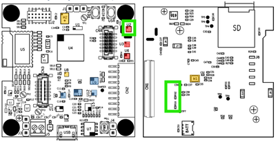

Which is the number you can see on the back side of the board? It should be 2431?
On the front side, is U2 unpopulated?
On 2431 production lot, the U2 sensor is unpopulated, thus exposing an IRQ pin. In previous lots instead, U2 sensor was available.
DATALOG2 up to the publicly available v3.1.0 is enabling that IRQ. So, 2431 boards have this IRQ pin left floating, thus generating the issue.
From the upcoming v3.2.0 this pin will be properly set up as GPIO_Analog, solving the bug.
