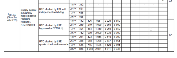

When it went into standby mode , the whole board was consuming 146uA. So the processor was consuming 146 -53uA (before the processor was added), a 96uA. Looking at the below table (I am using LSE and have a 32768KHz crystal attached) The power is close to 600nA ,

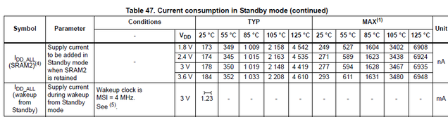

And with the above bottom table I have to add approx 180na for the ram. So in total the power should approx be 780na . Which is nothing like the 96ua which its drawing. To place into standby mode I am doing the following:

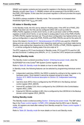

One hypothesis to this extra consumption would be the I/O states at board level before and during standby mode . can You please check and let us know if the observed behavior is fixed ?

Other potential source of "extraneous" consumption is the debugger keeping the processor running through the DBGMCU bits.

Thanks for the reply. I will check this when I am back in the office, but its something I never thought of. I thought when going into standby mode, all I/Os go into shutdown.
