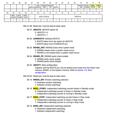

did you try to use IWDG_STDBY option byte.
It should make you able to freeze the watchdog in the specific low power mode.
You can modify it using STM32CubeProgrammer.
In shutdown mode, The PLL, the HSI16, the MSI, the LSI and the HSE oscillators are also switched off. Only LSE remains active, so you need to clock it from LSE. So, if you don't want IWDG to run in Shutdown, ensure you don’t start it before entering Shutdown.

Thanks Gyessine
I am aware of the IWDG_STDBY option byte but have not looked it, because it only solves the problem in standby, it does not solve the problem when in shutdown. So a fix for standby is of no use if there is no fix for shutdown.
