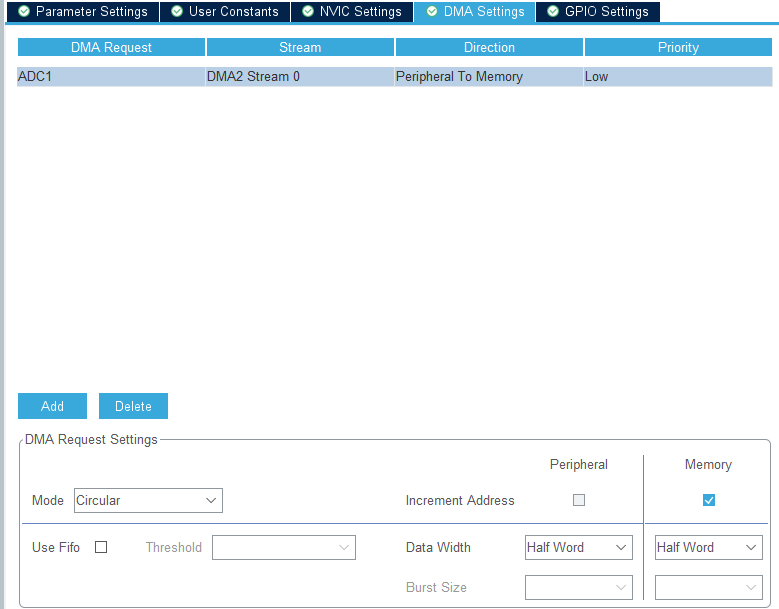

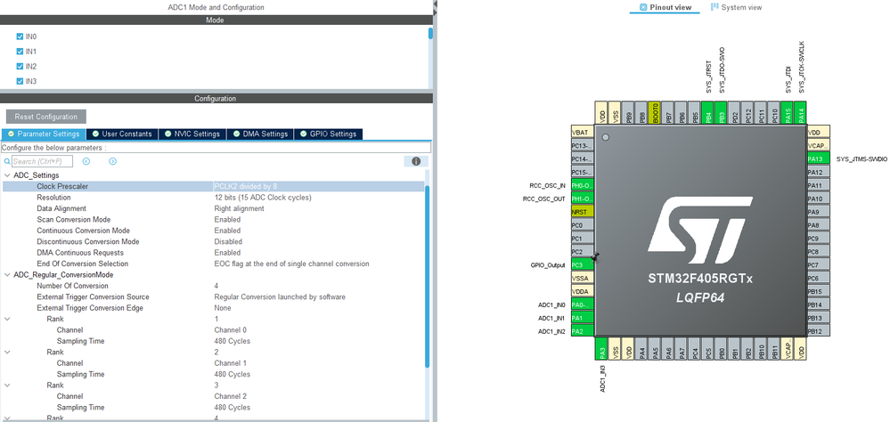

The ADC configuration I'm using is as below:

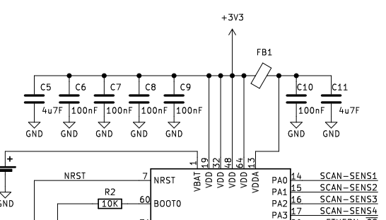

The voltage reference in the MCU is as below:

Schematic looks fine.
