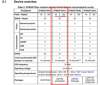

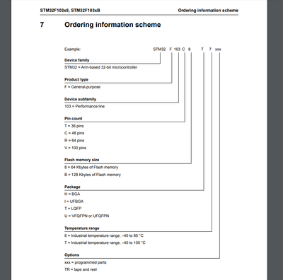

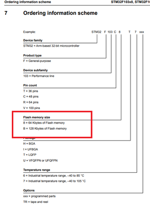

The answer is provided in the datasheet:
The only difference is the Flash size so you don't have to worry.
2024-11-04 3:15 AM
Thanks, so it's a yes on my request "1)", no issues replacing with STM32F103CBT6.
