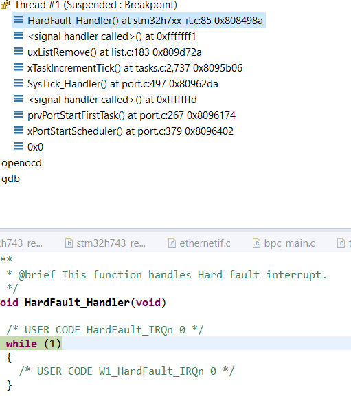

my code is jumping into hardfault handler during/after flash write procedure.some problem with mutex or task handling,
can somebody explains how to hold the thread until the flash write is complete.
note: flash write functions are called inside the "below normal " priority thread.
2021-04-19 6:21 AM
hi, i have fixed this issue,
there is problem in flashing of 96 K in 5 millisecond task, and other tasks are halt and ended with trap.
I have implemented a semaphore concept to flash block by block and the task un-interruption is solved.

2021-03-25 1:27 AM
_disable_irq();
do{
sl_ret = BPC_FLASH_Block_Erase_l(FLASH_BANK_SECTOR_6, FLASH_BANK_2, ERASE_SECTOR_PARAM);
}while(sl_ret!=B_TRUE);
osDelay(2000);
BPC_FLASH_FlashWrite_l(&infoBlock1,pccom_adr_flash, (U_INT8 *)pccom_adr_ram, laenge_long);
__enable_irq();
but i guess , since i copy 96 kb of data from RAM to flash during write leads to thread lock and then causes systick exception with hardfault handler
2021-03-25 2:27 AM
i dont have experience about your specific setup but isnt disable_irq() dissabling your RTOS scheduler?
and maybe breaking something else?
2021-03-25 3:35 PM
To add to what Javier already said... Why are you disabling interrupts at all? Why is there a delay function? Have you read the FLASH section in the reference manual and understand how it works?
