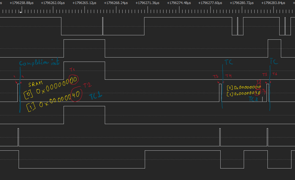

Thanks Tesla DeLorean for the helpful input. I realize I should have put up some signal form just to explain what I was after.
Summarizing my issue and solution:
Fixes:
Here is the currently working init and a picture that explains the data collected for portA

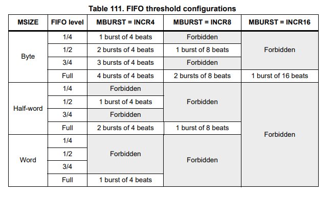

Do HT TC happen if FIFO is disabled? I don't want FIFO's because that adds latency.
The way I also understood the spec for BDMA is that for whole words the max Fifo depth is 4.
2022-09-01 9:11 AM
Fixes:
int InitializeDmaChannels(void)
