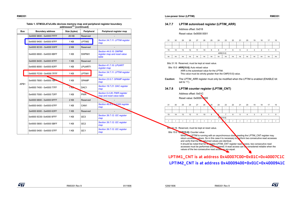

Hello, I have a Nucleo L476RG which I'm using for different projects, and I never gave an importance to the offset addresses that are written before every register in the reference manual.
Can anyone explain to me what are theses offsets.
2022-09-01 4:37 AM
Each register has its address. This is a 32-bit mcu so registers' addresses tend to be 4 bytes apart, even if they don't occupy the full 32 bits. You calculate the registers' address by adding the peripheral's address to the offset.
But this in fact is not very important in practice. There is a header file for each STM32, for example for 'L476 this. You normally #include this file indirectly, through #include "stm32l4xx.h" - this assumes you have set properly the include paths and also added a -DSTM32L476xx switch to the command line when calling compiler - IDEs do this for you automagically.
The device-specific header file (look into it) contains both the peripherals' addresses, and also structs which in fact express the registers' offset. So, for programming, you don't need to know the address nor calculate it, for example to read out the LPTIM1's CNT register into variable "count" you simply write:
count = LPTIM1->CNT;

In older days there was one set of peripheral registers that might span 128 bytes in a simple MCU, say 8051. You might get multiple instances with different chip selects as you added chips to your board externally, say a pair of 8255 8-bit GPIO devices and an 8250 Serial USART, etc
These day you have multiple, identical, peripheral instances, parked through memory, the registers within these peripherals are a certain depth/offset into the address space.
The base address for USART1 and USART6 will be different, but the data and status registers are relatively in the same position.

Thank you for the responses, so if I get it right, the registers where combined into one and separated by reserved bits, and the offset is how much of those reserved bits are there between every register.
Switching from Arduino to stm32 is a nightmare so far, the amount of time and effort that I spend to do simple things is way above what I was expecting, I even started to zoom on every single character in the reference manual to make sure I didn't skip any information, and that's how I got to the offset thing.
I hope that they are not very important because I don't want to bother my brain with other factors.

There are voids in the address space for the peripherals
Addresses of registers within the 4GB addressable space (32-bit)
printf("%p\n", &LPTIM1->CNT);
printf("%p\n", &SCB->VTOR);
