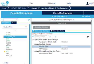

D-cache should not make things more difficult , so i recommend to not use it.
Just in Cube do not enable it, later can enable and do the cache management - was my idea, to make it more easy.

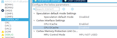

H7A3 has D-cache - how you manage this /with dma ? (see nothing in your text)
Simple solution: switch off (or not enable) D-cache . (NOW ! if bdma working...can work on this, cache management.)

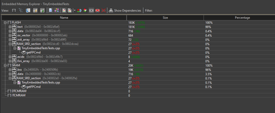

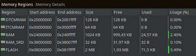

@AScha.3 That helps a lot but I'm not there yet.  I modified my test code to look like this:
//Per the reference manual (RM0455), BDMA only has access to SRD ram section
__attribute__((section(".RAM_SRD_section"))) ALIGN_32BYTES(std::uint8_t  getFPCmd[]) = "abcdefghijklmnopqrstuvwxyz";
TEST(CPFTestGroup, LPUARTTest)
	const uint32_t getFPCmdSize = sizeof(getFPCmd);
	SystemClock::configSystemClock();
	MX_LPUART1_UART_Init();
	MX_BDMA2_Init();
	for (int i = 0; i < 128; i++)
		LL_LPUART_TransmitData8(LPUART1, i);
		LL_mDelay(1);
    //Setup TX
	LL_BDMA_ConfigAddresses(BDMA2, LL_BDMA_CHANNEL_1, reinterpret_cast<uint32_t>(getFPCmd),
		LL_LPUART_DMA_GetRegAddr(LPUART1, LL_LPUART_DMA_REG_DATA_TRANSMIT),	LL_BDMA_DIRECTION_MEMORY_TO_PERIPH);
	LL_BDMA_SetDataLength(BDMA2, LL_BDMA_CHANNEL_1, 16);
	LL_BDMA_EnableChannel(BDMA2, LL_BDMA_CHANNEL_1);
	LL_LPUART_EnableDMAReq_TX(LPUART1);
	LL_mDelay(2000);
	std::cout << "LPUARTTest Done" << std::endl;
and modified the STM32H7A3LI_flash.lds file using VisualGDB to look like this
/* Generated by LinkerScriptGenerator [http://visualgdb.com/tools/LinkerScriptGenerator]
 * Target: STM32H7A3LI
 * The file is provided under the BSD license.
ENTRY(Reset_Handler)
MEMORY
	FLASH (RX)    : ORIGIN = 0x08000000, LENGTH = 2M
	SRAM (RWX)    : ORIGIN = 0x24000000, LENGTH = 1M
	DTCMRAM (RWX) : ORIGIN = 0x20000000, LENGTH = 128K
	ITCMRAM (RWX) : ORIGIN = 0x00000000, LENGTH = 64K
	/* --- begin generated external memories -- */
	RAM_SRD (RWX) : ORIGIN = 0x38000000, LENGTH = 32K
I forgot: you have to add this to the xxx_flash.ld file   (just before the comment line : /*Remove... )
  .RAM_SRD_sec :					/* (NOLOAD) <- no initialize */
   	. = ALIGN(32);
    *(.RAM_SRD_section)
    . = ALIGN(32);
  } >RAM_SRD
  /* Remove information from the compiler libraries */
And after mod the xxx_flash.ld file you see it is used ? ->
Now it should work.   8)

VisualGDB has a nice embedded memory explorer and here's what it shows.
Both DCache and ICache were already disabled in CubeMX so that probably wasn't my issue.
