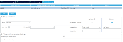

The CubeMX Mode and params are set up as:
and

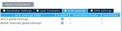

NVIC settings:
with DMA settings:
Also Register Callbacks are set to enable for ADC.
So what did I miss?
This did work a little as I was debugging and setting breakpoints. Pausing at the first HAL_ADC_Start_DMA call and stepping into the Hal code to verify parameters being passed, I then pushed play and hit the break point in the callback. However, continuing past the break point in the callback, I did not get anymore passes through the callback. Then, for reasons unknown this would not occur anymore after code changes that I cannot recall the sequence of. Now it does not work at all.

BDMA, DMA1 and DMA2 do not have access to the DTCM memory. BDMA has access to SRAM4 in D3 only. Please refer to the reference manual.

2024-04-10 8:50 AM
Setting the DMA to DMA1 fixes the issue. Thought I had tried this before and failed, but I must have had other issues in the setup.
