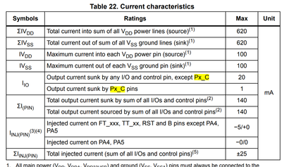

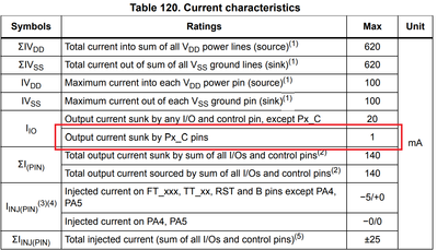

The constraint on PXY_C pins is the current as the internal switch doesn't support more than 1mA:
DS12110 Rev 10:

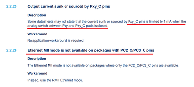

From the errata ES0392 - Rev 13:
Errata on the max current and the ETH function:
So you need to insure that you have =< 1mA load on the pin.
