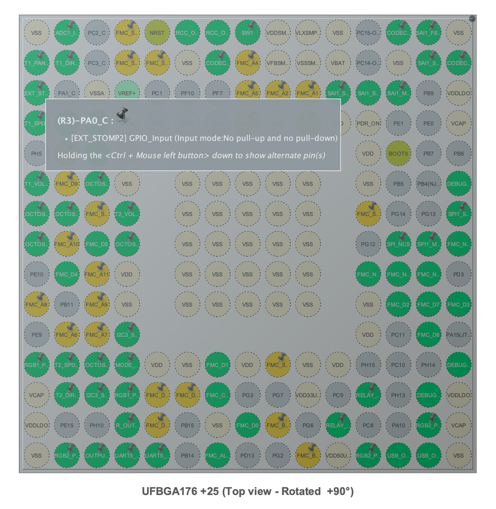

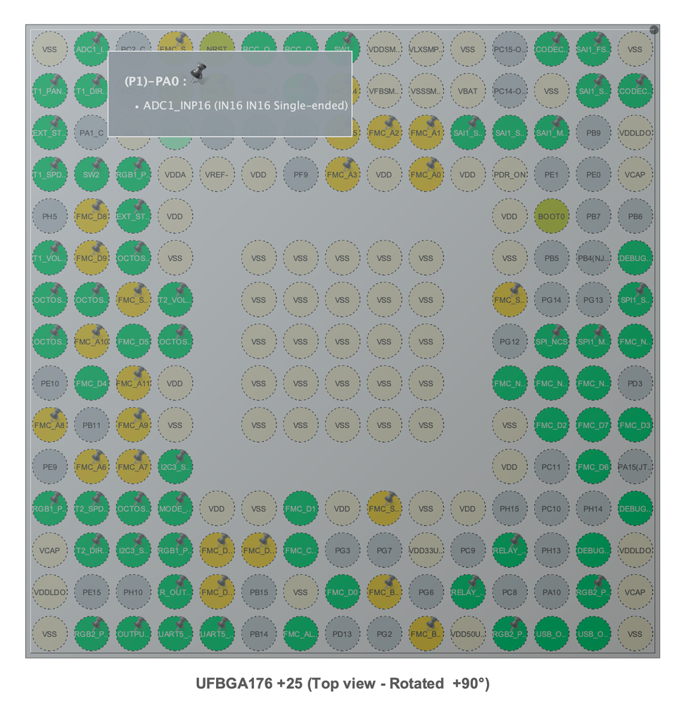

Sharing screenshots of PA0_C and PA0 configuration. Note that PA0_C does not work even if I deactivate the ADC function on PA0.

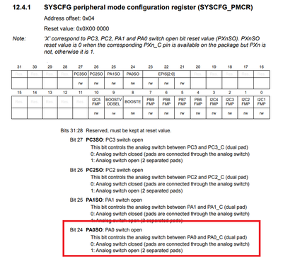

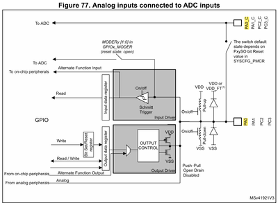

The Reference Manual seems consistent to me in explanation, especially Figure 77. Only thing PA0_C can do on its own (i.e. without the analog switch) is ADC. When the switch is closed, the two pins are tied--they are no longer independent.
