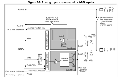

I am using pc2_c and pc3_c, which are supposed to work with USB, although I've heard they're more susceptible to (static?) damage.

Probably you killed a xx_c pin.
It happened to me when using such an pin for SPI to a small display. It was working until I tested it with higher clock rate. Was working some seconds then died away.
This pin never worked again.
So I avoid these xx_c pins for any output signal, just using it as a slow input is okay, or as analog input.
The _c pins are connected through an anlog switch - that can easily be destroyed ....
So maybe you killed it by driving more than 1mA on these pins...

I'm a little worried I destroyed the _c pins. Although for ULPI they're input pins, right? So there shouldn't really be a risk of overdrive. I don't really have a way to remove the PHY from the circuit without fully taking it off the board, which I would prefer not to do if possible.
Right, so it should not damage them. (As i did by increasing clock from 12M to 32 Mhz , about)

If you want to verify Px_C pins still work, you could set them as output and toggle, verify the input follows output. You could also set them as analog and verify ADC returns appropriate values but this may take more rework than is possible.
