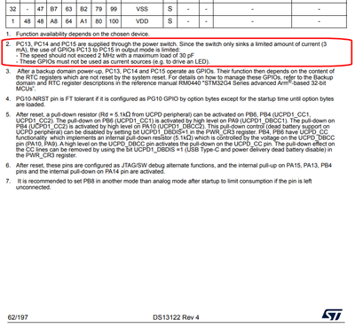

It gives you a lot more detail than that:
which is, surely, enough to answer the question?

Ask yourself:
  • Does this unnamed  "level translator" require more than 3mA drive current ?
  • Does its load capacitance exceed 20pF ?
  • Does your signal exceed 2MHz ?
that should answer your question.
BTW: Note that the datasheet is incorrect in saying, "the switch only sinks (sic) a limited amount of current" - they mean sources.

Here:
https://www.st.com/resource/en/datasheet/stm32g491mc.pdf#page=62
