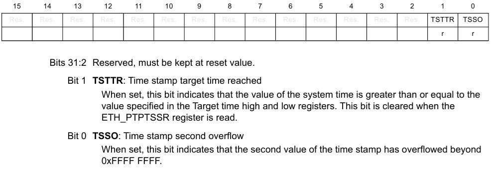

in file stm32f767xx.h
/* Bit definition for Ethernet PTP Time Stamp Status Register */
#define ETH_PTPTSSR_TSTTR_Pos (5U)
#define ETH_PTPTSSR_TSSO_Pos (4U)
need replace to
#define ETH_PTPTSSR_TSTTR_Pos (1U)
#define ETH_PTPTSSR_TSSO_Pos (0U)
rm0410-stm32f76xxx-and-stm32f77xxx-advanced-armbased-32bit-mcus-stmicroelectronics.pdf
rev 5 July 2024
2025-05-05 1:13 PM - edited 2025-05-06 4:24 AM
Hello @vv22 and welcome to the ST Community.
Thank you so much for reporting this typo. I've reported internally for correction on the future (under internal ticket number 209119).
