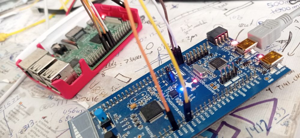

I am trying to flash code in my stm32 via SWD interface with a raspberryPi.(swd is bitbanged no stlink used)
With my raspberryPi Zero i followed this tutorial, wired the raspy with my stm32f105 together.

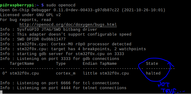

So, i changed configurations a bit and using my raspberry 3 model B v1.2 made it "work"
Now the cubeIDE is able to halt the stm32 chip and step trough the code (debug build)

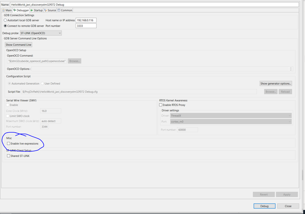

it took me a while but if i untick "enable live expressions" (right click in the progect>debug as>debug configuration>debugger)
the debugger was able to halt the programm at runtime.
for now im able to load the programm and halt the mcu (trough cubeide debugger).
Im not able to reset the mcu for some reason.
