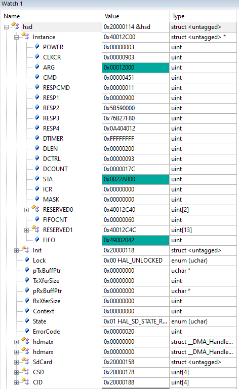

Hi, I have issues while using "FATFS R0.12c" over SDIO on my STM32F407. I do SDIO write to file on main loop, but I also have "TIM2/TIM3/CAN1 RX0/CAN1 RX1" interrupts which has other logic (for example TIM2 sends UART message every 100ms to update the screen). Writing to file sometimes works, but eventually it returns "hsd->ErrorCode = 0x20" which means "HAL_SD_ERROR_RX_OVERRUN".
I have tried: reducing interrupt duration; using DMA on SDIO with highest priority interrupts; using non-DMA SDIO settings; increasing "hsd.Init.ClockDiv" for slower writes - but none of these things completely eliminat the error.

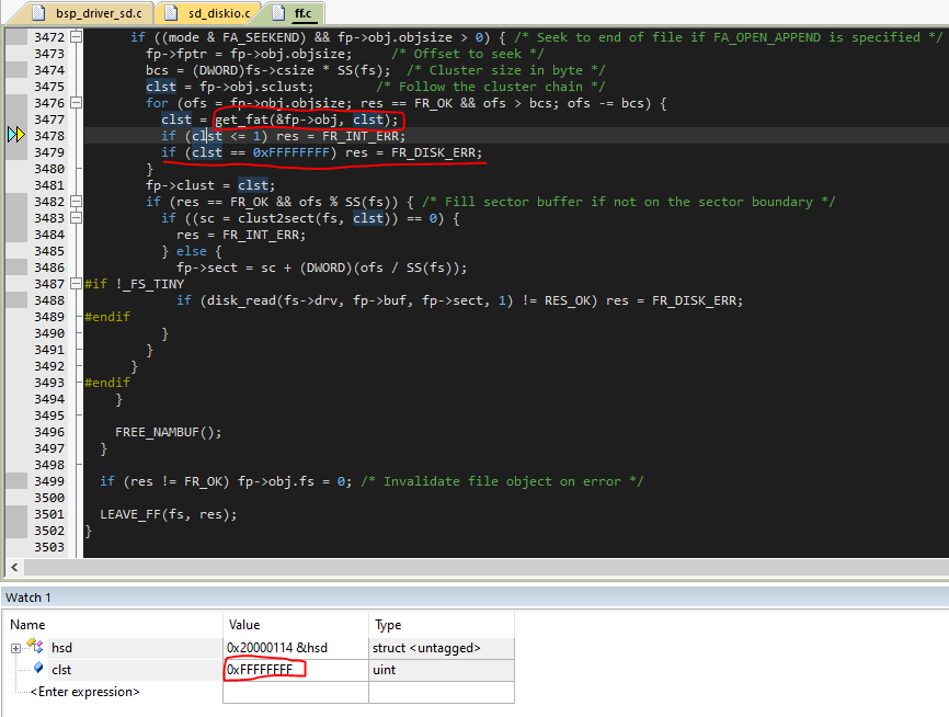

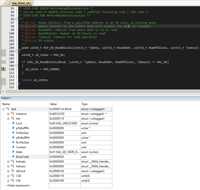

I am looking at "bsp_driver_sd" layer error "HAL_SD_ERROR_RX_OVERRUN" which occur here:

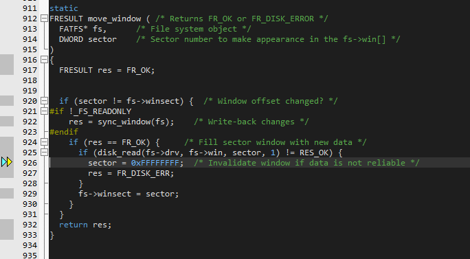

It seems to originate from "f_open" when it tries to seek to end of file, fails on "get_fat" (but it seems to be random and sometimes it fails on other f_open places when HAL_SD_ReadBlocks returns HAL_SD_ERROR_RX_OVERRUN):
f_open->get_fat->move_window->SD_read->disk_read (BSP_SD_ReadBlocks)->HAL_SD_ReadBlocks returns HAL_SD_ERROR_RX_OVERRUN and f_open fails with FR_DISK_ERR because get_fat returns clst = 0xFFFFFFFF.
