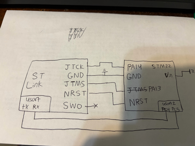

I'm back, and working with the stm32g070rb chip. I did prototyping on a nucleo board based on the same chip (split the st link and nucleo board), and wired the ST Link to the microcontroller with the following connections
I used open-ocd for flashing code to the nucleo, and it worked flawlessly. Based on the wiring, I made the assumption that this'd translate directly when developing the PCB.

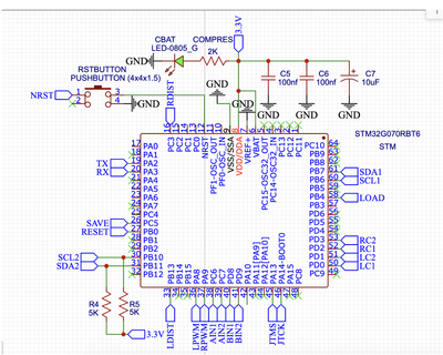

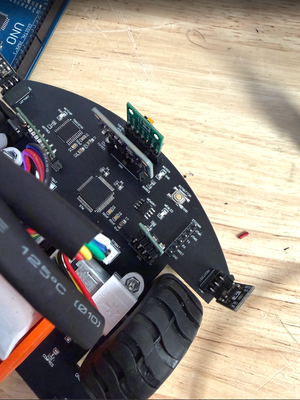

(picture of the PCB and the schematic)
When I tried to make the same connections, and tried to flash, I'd get the following issue

I'm unsure about how to start diagnosing. Is there anything in the schematic that's missing? I understand this is a lot to ask, but I'd appreciate any insight!

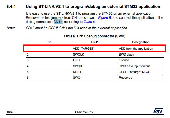

PS:
From the Nucleo board's User Manual:
https://www.st.com/resource/en/user_manual/um2324-stm32-nucleo64-boards-mb1360-stmicroelectronics.pdf#page=16
via: https://www.st.com/en/evaluation-tools/nucleo-g070rb.html#documentation

PS:
