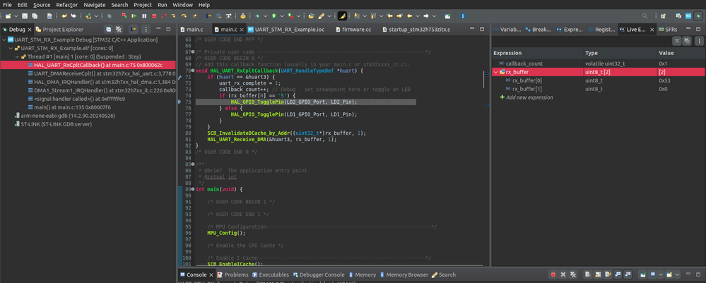

Below I have snippets for the UART Callback functions and main functions for the transmitter and receiver. I also have a screenshot of STM32CubeIDE that shows in the debug view the matching data in rx_buffer on the first iteration.

I checked again, it looks like the problem does exist in debug too. If the first point I break is line 73, the if statement ` if(rx_buffer[0] == 'S' ` , then it does show me that the data in the rx_buffer[0] is 0x0. This is strange because I would expect that the DMA would only have triggered if there was data received, and if that is the case I would expect that it would be whatever data was received over UART. So for the first iteration, the data is not showing up.
