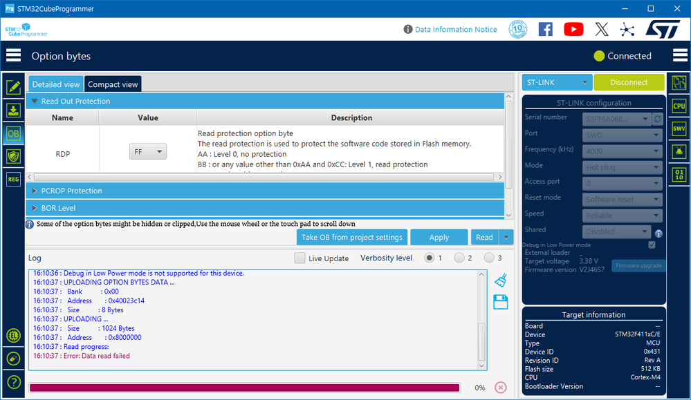

I am currently developing a board using the stm32f411ret6 chipset.
I confirmed that the first firmware download worked properly on one of the boards I am developing.
However, after attempting to download the second firmware, I encountered an issue where the option byte was displayed as 0xFF.
I tried changing the option byte in various ways, but all attempts failed.
Furthermore, I attempted to boot using the system bootloader, but it failed. Could the flash memory itself be damaged?

I executed the below commands with Open On-Chip Debugger.
(1) Check that no flash memory operation  (OK)
> mdw 0x40023c0c
0x40023c0c: 00000000
(2) Write Flash CR Key1, Key2  (OK)
> mww 0x40023C08 0x08192A3B (FLASH CR KEY1 : 0x45670123)
> mww 0x40023C08 0x4C5D6E7F (FLASH CR KEY2 : 0xCDEF89AB)
(3) Write the desired option value in the FLASH_OPTCR register. (OK)
> mww 0x40023C14 0x0FFFAAEC
> mdw 0x40023C14
0x40023c14: 0fffaaec
(4)  Set the option start bit (OPTSTRT) in the FLASH_OPTCR register and Wait for the BSY bit to be cleared (OK)
> mww 0x40023C14 0x0FFFAAEE
waiting for a minutes  ...
> mdw 0x40023c0c
> mdw 0x40023C14
0x40023c14: 8fffffec
(5)  Read FLASH_OPTCR  after reset
> reset
Unable to match requested speed 2000 kHz, using 1800 kHz Unable to match requested speed 2000 kHz, using 1800 kHz [stm32f4x.cpu] clearing lockup after double fault [stm32f4x.cpu] halted due to debug-request, current mode: Thread xPSR: 0x01000000 pc: 0xfffffffe msp: 0xfffffffc [stm32f4x.cpu] Polling failed, trying to reexamine [stm32f4x.cpu] Cortex-M4 r0p1 processor detected [stm32f4x.cpu] target has 6 breakpoints, 4 watchpoints [stm32f4x.cpu] Examination succeed
> mdw 0x40023C14
0x40023c14: 8fffffed
(6)  Read FLASH_OPTCR  after power off/on
> mdw 0x40023C14
0x40023c14: 8fffefed
After all that,  the option byte has still the broken value (0xff)
