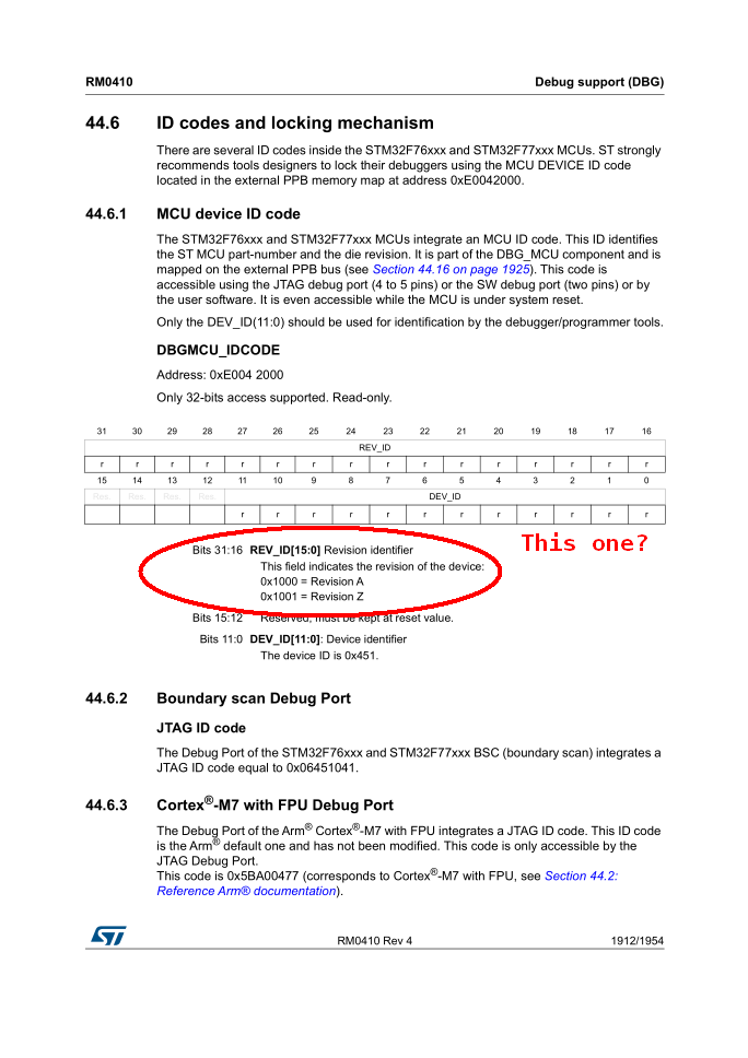

2019-01-21 9:10 AM
I realize that I can read the ID Code Register at 0xE0042000, but I am not sure how the silicon revision is indicated for a specific device. Is it readable though the codes on the device itself?
2019-01-21 9:22 AM
void CORECheck(void) // sourcer32@gmail.com
uint32_t cpuid = SCB->CPUID;
uint32_t var, pat;
printf("CPUID %08X DEVID %03X REVID %04X\n", cpuid, DBGMCU->IDCODE & 0xFFF, (DBGMCU->IDCODE >> 16) & 0xFFFF);
pat = (cpuid & 0x0000000F);
var = (cpuid & 0x00F00000) >> 20;
if ((cpuid & 0xFF000000) == 0x41000000) // ARM
switch((cpuid & 0x0000FFF0) >> 4)
case 0xC20 : printf("Cortex M0 r%dp%d\n", var, pat); break;
case 0xC60 : printf("Cortex M0+ r%dp%d\n", var, pat); break;
case 0xC21 : printf("Cortex M1 r%dp%d\n", var, pat); break;
case 0xC23 : printf("Cortex M3 r%dp%d\n", var, pat); break;
case 0xC24 : printf("Cortex M4 r%dp%d\n", var, pat); break;
case 0xC27 : printf("Cortex M7 r%dp%d\n", var, pat); break;
default : printf("Unknown CORE\n");
else
printf("Unknown CORE IMPLEMENTER\n");
// FPU Programmer Model
// http://infocenter.arm.com/help/index.jsp?topic=/com.arm.doc.ddi0489b/Chdhfiah.html
void FPUCheck(void) // sourcer32@gmail.com
uint32_t mvfr0;
printf("%08X %08X %08X\n%08X %08X %08X\n",
*(volatile uint32_t *)0xE000EF34, // FPCCR 0xC0000000
*(volatile uint32_t *)0xE000EF38, // FPCAR
*(volatile uint32_t *)0xE000EF3C, // FPDSCR
*(volatile uint32_t *)0xE000EF40, // MVFR0 0x10110021 vs 0x10110221
*(volatile uint32_t *)0xE000EF44, // MVFR1 0x11000011 vs 0x12000011
*(volatile uint32_t *)0xE000EF48); // MVFR2 0x00000040
mvfr0 = *(volatile uint32_t *)0xE000EF40;
switch(mvfr0)
case 0x00000000 : puts("No FPU"); break;
case 0x10110021 : puts("FPU-S Single-precision only"); break;
case 0x10110221 : puts("FPU-D Single-precision and Double-precision"); break;
default : puts("Unknown FPU");
void IDCODECheck(void) // sourcer32@gmail.com
uint32_t idcode = DBGMCU->IDCODE & 0xFFF;
switch(idcode)
case 0x423 :
case 0x433 : printf("STM32F401\n"); break;
case 0x431 : printf("STM32F411\n"); break;
case 0x411 : printf("STM32F457 or F20x\n"); break;
case 0x413 : printf("STM32F405 or F407\n"); break;
case 0x419 : printf("STM32F429 or F439\n"); break;
case 0x421 : printf("STM32F446\n"); break;
case 0x434 : printf("STM32F469\n"); break;
case 0x441 : printf("STM32F412\n"); break;
case 0x440 : printf("STM32F030x8\n"); break;
case 0x442 : printf("STM32F030xC\n"); break;
case 0x444 : printf("STM32F030x4 or F030x6\n"); break;
case 0x445 : printf("STM32F070x6\n"); break;
case 0x448 : printf("STM32F070x8\n"); break;
case 0x417 : printf("STM32L0 Cat 3\n"); break;
case 0x447 : printf("STM32L0 Cat 5\n"); break;
case 0x435 : printf("STM32L43xxx or L44xxx\n"); break;
case 0x415 : printf("STM32L475xx, L476xx or L486xx\n"); break;
case 0x461 : printf("STM32L496xx or L4A6xx\n"); break;
case 0x462 : printf("STM32L45xxx or L46xxx\n"); break;
case 0x470 : printf("STM32L4Rxxx or L4Sxxx\n"); break;
case 0x449 : printf("STM32F74xxx or F75xxx\n"); break;
case 0x451 : printf("STM32F76xxx or F77xxx\n"); break;
case 0x452 : printf("STM32F72xxx or F73xxx\n"); break;
case 0x450 : printf("STM32H7xx\n"); break;
default : printf("Unknown STM32\n");
2019-01-21 9:31 AM
From the F746
From the F767
2019-01-21 2:39 PM
2019-01-21 6:14 PM
A cleaner list of CM7 parts in ST's portfolio
H743XI Z
CPUID 411FC271 DEVID 450 REVID 1001
Cortex M7 r1p1
STM32H7xx
C0000018 20000F48 00000000
10110221 12000011 00000040
F746ZG
CPUID 410FC271 DEVID 449 REVID 1001
Cortex M7 r0p1
C0000000 FFFFFFF8 00000000
10110021 11000011 00000040
F767ZI
CPUID 411FC270 DEVID 451 REVID 1000
Cortex M7 r1p0
F722ZE
CPUID 411FC271 DEVID 452 REVID 1000
Cortex M7 r1p1
