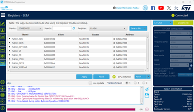

I also sense the OPTVERR bit being set must be a huge clue, but I can't understand how this would ever get set since the HARDWARE calculates and stores the bits and their complementary values.  I can clear this bit in code but it comes back on the next shutdown/wake cycle.
> Thanks for the hint.  I should have mentioned that point.  Calling HAL_FLASH_OB_Launch does not change behavior (RDP remains at level 0).
In that case, it sounds like your option byte configuration in flash is invalid, in which case the default options will be set (but the registers will still hold their bogus values). You can verify this by looking at the option byte registers after startup and ensuring the complimentary words are consistent.
To get out of this state, you will need to write ALL of the option bytes, then apply them with OBL_LAUNCH or POR. Only writing RDP will not fix other option bytes which are invalid and you will be stuck in this state. I'd recommend setting them all to their production values as given in the RM.

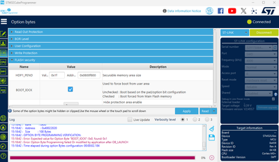

Thanks folks:  It just struck me that I should have mentioned this, whether it is a red herring or not: The only parts I have access to were provided by ST are pre-production samples. Using the STM32CubeProgrammer I have exactly the same results with the programmer that I do with my code:  No ability to change the RDP level.  Images are attached below but I'll summarize:
I have attempted to change the BOOT_LOCK bit or the RDP level from 0xAA to 0xBB.  Both changes result in errors for expected values and Option Byte Programming failed Or modified by application after OB_LAUNCH.  (From what I can tell, the STM32CubeProgrammer is unable to change any other option bytes either - with similar errors - and following a full chip erase, so there is no code runable on the device.)  Parts which have never been loaded with software that tries to modify Option Bytes have BOOT_LOCK=1 and OPTVERR=1 and HDP1EN=0 (not 0xB4 as the default should be.)
I have found one part which does NOT have BOOT_LOCK or OPTVERR set (and have HDP1EN=0xB4.)  This part also shows a "Bootloader Version" of 0x0A whereas the others show 0xFF (as shown under Target information in the STM32CubeProgrammer.)
Is it possible I just have unhappy silicon?  If so, I'd like some positive identification of the issue as I need to develop production RDP level 1 code on these devices as of a week ago.
