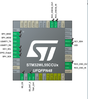

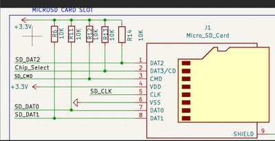

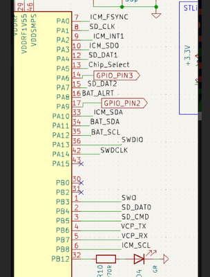

I will attach my PCB Layout as well as IOC file screenshot for reference. I am using this tutorial https://01001000.xyz/2020-08-09-Tutorial-STM32CubeIDE-SD-card/.
I got it working on a nucleo board, but am transitioning over to the PCB now.
After some debugging, I found that the error is coming from this function.
