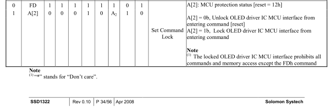

displaySend(SEND_CMD, 0xFD); // Set Command Lock (MCU protection status) ok
displaySend(SEND_CMD, 0xAE); // Sleep On (DisplayOFF) ok,
0xFD has one parameter
I haven't checked the rest of your sequence.
displaySend(SEND_DAT, 0x12); // = Reset Unlocked Oled driverdisplaySend(SEND_CMD, 0xAE); // Sleep On (DisplayOFF) ok,
What about the rest?
