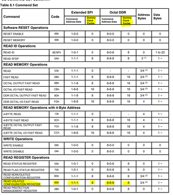

Please make sure that when reading volatile register 0x85h the dummy cycles are "8" not "0" referring to the memory datasheet table 8.1.

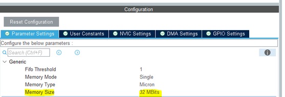

Could you please check the memory size. According the memory datasheet the the IS25LX032 memory size is 32Mbits.
The last version of STM32CubeMX 6.12 for windows uses the Bits unity for memory size. So, the memory size must be configure to 32MBits in STM32CubeMX. Please take a look at this post to check the memory size.

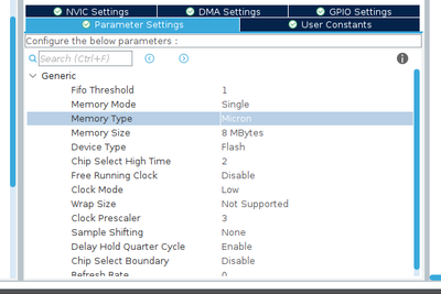

Hi Kaouthar,
the memory size is correct, it's 8MBytes. I am using the IS25LX064 Flash which has 64Mbits (8Mbytes).
