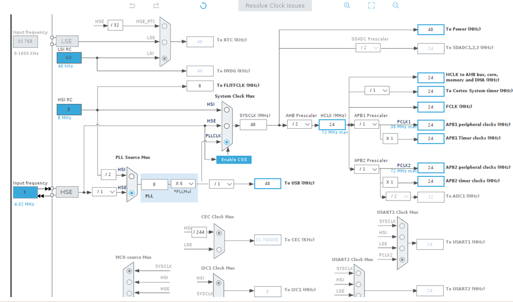

I think my issue is related to my clock settings. I have USB set to 48Mhz but can someone take a look an let me know if the 24Mhz are potentially causing a USB CDC timing issue?
This config does causes the USB descriptor string to sometime be corrupted:
This config causes USB descriptor to be sometimes corrupted.

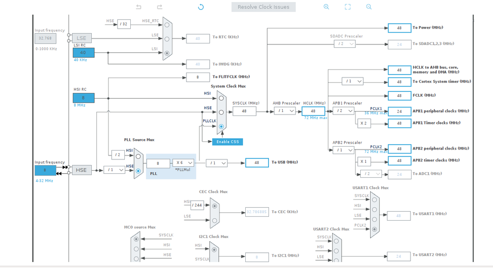

This config seems to work, but my code has references to 24Mhz so I would need to update my code if I change all APB clocks to 48Mhz. ( I would prefer to keep my clock settings as-is with 24Mhz APB clocks )
My code uses a 24Mhz clock with SysTick dividing by 1000 to produce a systick at 24Khz. I don't want to change that part of my code so I hope I can also get USB CDC's clock set correctly at 48MHz.
This config works
