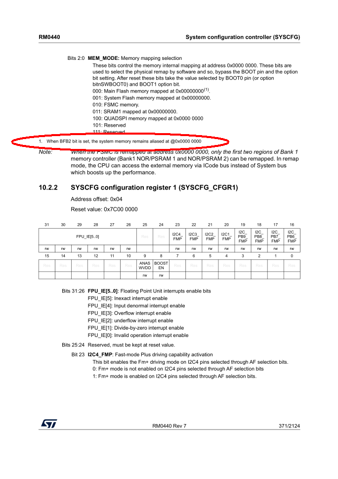

> FLASH_OPTR register has a value of 0xfbff'f800
That means, BFB2=1:
and if VTOR = 0, your interrupts end up at addresses given by system memory's vector table.
