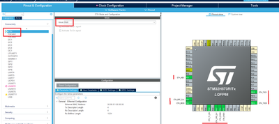

Did you refer to the datasheet / Table 15?
You can also do the exercise with STM32CubeMx:
Select the MCU part number, and activate the ETH in RMII mode:

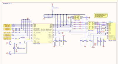

Hello @C2Chandan and welcome to the ST community,
You can inspire from the NUCLEO-H563 board schematic. It uses already ETH RMII:
