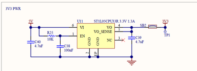

2025-03-05 1:34 AM - edited 2025-03-05 1:35 AM
Most probably that regulator was broken:
Check if you have 5V on R25 or C40 pads. If you get that voltage, this means (unfortunately) the regulator is broken. Need to have another board.
2025-03-05 1:43 AM
I got 0.98V on R25 and C40 pads

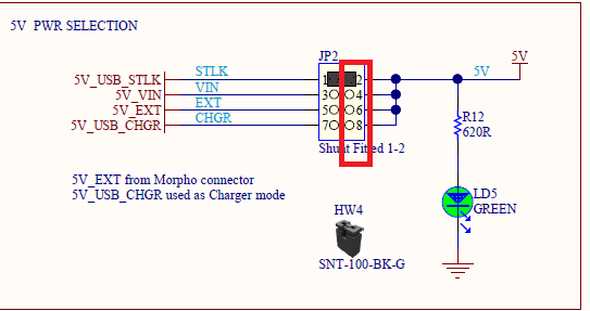

1- Are you sure you don't have 5V on the JP2?
2 - LD5 is normally lit?

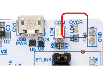

4 - LD6 is normally lit?
2025-03-05 2:09 AM
Yes i am sure that i don't have 5V on JP2
LD5 is very -very dim

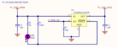

2025-03-05 2:12 AM - edited 2025-03-05 2:24 AM
What about the voltage level on 5V_USB_CHRG (check R2 pad)?
LD6 is lit?:
2025-03-05 2:24 AM
Yes this is lit
2025-03-05 2:32 AM
If LD6 is lit: you have an overcurrent on the board.
If you remove JP2:
LD6 still lit?
2025-03-05 2:34 AM
When I remove JP2 LD6 is not lit
